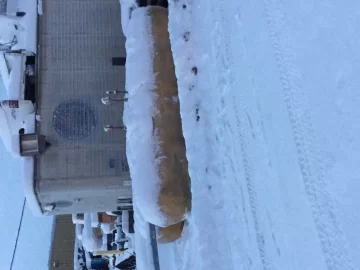

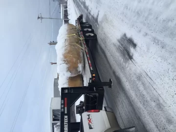

Here is the fun part, i ran into a deal for 2 - 1000 gallon propane tanks already spray foamed
Only $850 for both, 20 miles round trip
Now do i install the new tanks
Absolutely
But do i keep the existing
At what point is too much storage a factor

That's a steal. there is more in foam there than $850. make sure to pressure test well, and that the foam isn't hiding anything.
did you pipe up as I drew where the 250 was the pellet buffer and the 1250 was for wood? if so, I would just replace the 2x500's with 2x1000's, and use the 250 still for pellets. 2000 is a lot of storage for an effecta 60 if you're using it hard. it's at the max end of the recommended storage. if you have a narrow delta t though (you have baseboard heat as I recall) it will be a help.
good luck.
karl
Yep, 250 for pellet mode and 1250 for wood mode
seems to work with the baseboards pretty well down to 145
i think im gonna put an 8 foot pit in new boiler room and set new tanks vertical
