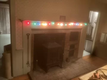

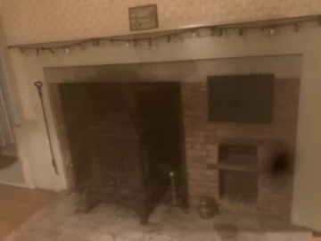

3) The third stove is a very pretty one (but maybe the least functional). This fits in the dining room fireplace. I am trying to decide if I will use that stove or use the open fireplace. Either way, it would be burned very occasionally during some dinners.

But... if this old antique free standing stove blows smoke right up the fireplace flue.... is that really any WORSE that just burning the open fireplace? I mean, I will get to the liner when I can (if I use the stove). But... as of right now... it is an open fireplace anyway that accepts wood directly in the fireplace. The antique stove is wide open (holes by design). Isn't this at least a bit better than the open fireplace? Or is there some factor that I am not considering?

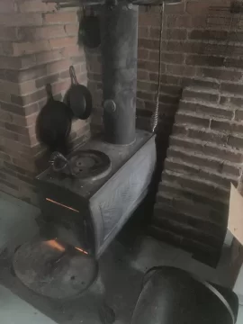

Can you post some pics?

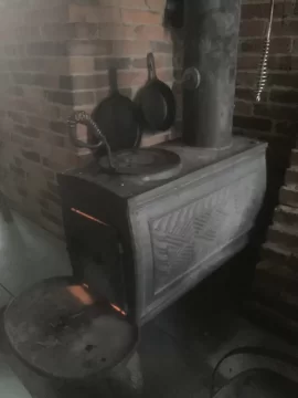

This is the little kitchen stove that I like so much. Incredibly, it has been the most functional and enjoyable stove in this house.

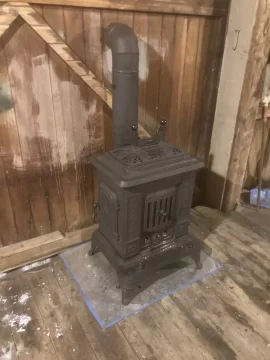

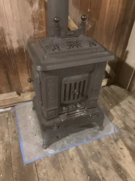

And then below is the very old stove that fits in my dining room fireplace (instead of burning wood in open fireplace). I just have it out in the barn because I was doing some work on it (and testing it)
[Hearth.com] efficiency [Hearth.com] efficiency
WIth respect to your favorite stove, you know you are in trouble when you can see the glow of flames around the door;) Built for heat, not efficiency.
