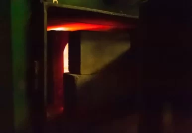

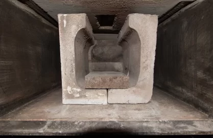

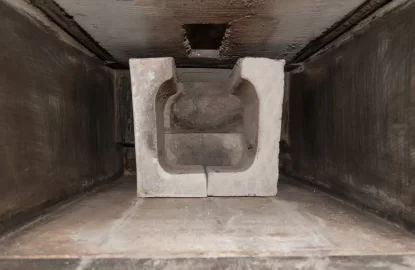

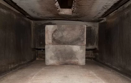

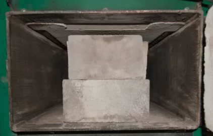

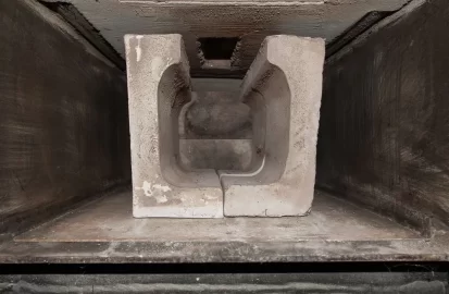

After better than two years on the shelf, I am now using the new style secondary refractory in the Eko 25. The originals broke into too many sections and it became a hassle to R&R for cleaning. I gotta say, so far so GREAT!
The original refractory worked well enough with additional firebrick for damming. With the new style refractory, firebricks work well for directing the blue flame and taking abuse. Firebricks are an easy and economical maintenance item. My procedure is as follows:
  1. Place two firebricks stacked on edge horizontally and slide to the rear until 1-1/2" from the bulkhead
  2. Slide two tunnel pieces to butt against the two stacked firebricks, and then ad the other two butting to the first pair
  3. Lay two firebrick splits on the floor of the tunnel to absorb the abuse of the blue jet wash, one is cut short to fit
  4. Place two more firebricks stacked on edge horizontally 1-1/2" from the refractory pieces to absorb the abuse of the blue jet wash thus saving the door refractory
The path of the blue flame comes straight down and can only go towards the door end of the chamber, it then hits the two firebricks and squirts to the left and right hitting the sidewalls of the water jacket and heading towards the exchanger tubes. So far am very satisfied with the new setup. After dialing down the fan speed it will not blast the sidewalls, but by then, the refractory and firebricks are glowing. Hopefully these new pieces will be more durable and far outlast the firebricks.
