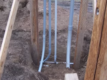

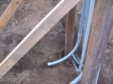

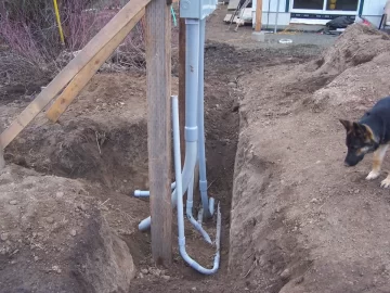

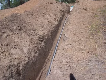

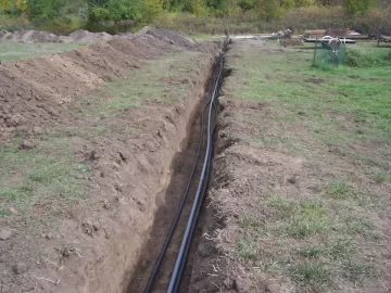

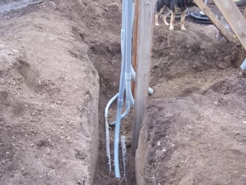

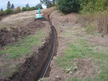

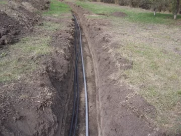

DIY, I was so happy to push dirt over this stuff. 400+ feet of trench filled with power and water poly pipe to the house, the cisterns and the well.
  • [Hearth.com] Electric Install
It was cheaper to have the trench dug in 3.5 hours rather than take weeks to do it myself. I placed the pipes and conduit and then backfilled with my mini mini ex.

Is that schedule 80 conduit above grade? The abovegrade stuff seems to be a different color so I suspect it is. That's a code requirement now.
Also, isn't there a specific distance that water and electric have to be separated by?
80 above, 40 below, no separation required. Frost line is at 36, bottom of trench is at 42.
Reactions: Highbeam
