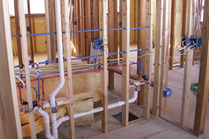

How is changing copper to plastic piping an upgrade? Copper has several advantages, especially if it is already existing. Yes, PEX may be easier to work with, but it's still plastic.When I upgraded to pex from copper I disconnected the plumbing ground. My waste pipes are copper so I kept that ground attached.
Copper corrodes and can burst if it freezes.How is changing copper to plastic piping an upgrade? Copper has several advantages, especially if it is already existing. Yes, PEX may be easier to work with, but it's still plastic.
PEX Plumbing Disadvantages: What You Need to Know
When it comes to thinking about installing or replacing your plumbing, you probably get overwhelmed by the options. Even if you are doing a smaller job, it can quickly spiral out of control as you stand at the hardware store trying to determine the right materials, sizes, and shapes. PEX...smartchoice.plumbing
There are advantages to each. My house had a copper plumbing system with lots of nonfunctional shutoffs and it had been tapped into and modified so many times it wasn't worth trying to work with. So I went with a manifold block and PEX it was much cheaper faster and easier than replacing with copper.How is changing copper to plastic piping an upgrade? Copper has several advantages, especially if it is already existing. Yes, PEX may be easier to work with, but it's still plastic.
Yes, I can see if the house plumbing is a total mess how it could be an upgrade. It's cheaper, faster and easier, but with caveats. Once properly set up, copper is no maintenance. I will stick with all copper supply plumbing in our house. Health and rodent concerns outweigh the advantages for me.
