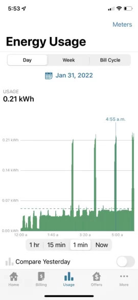

My utility installed smart meters. And now I have a free hub that interfaces with the meter and I can measure real-time power consumption. It’s pretty handy. I can turn an appliance off or a a breaker (just no the one one with my hub and WiFi router) and see the change.
This was todays and the spikes are where the heatpump goes into defrost and kicks on 10kw heater.

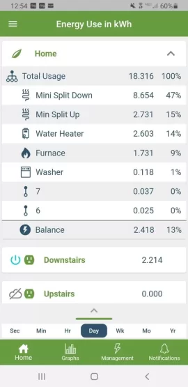

Emporia just released the Vue 2 for $150 that can monitor 16 circuits. This would show you exactly where your energy use is. I only got around to installing it on my main larger loads. You can also monitor your solar with the unit if it's feed into your main panel.

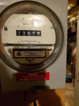

It looks like you have an old style rotating dial meter. Those make it pretty easy to watch the usage change as you turn breakers on and off. I'd account for what any breaker that causes the meter to spin significantly in cold weather is doing with the power, starting with the 220v breakers. This would be best done at night when your solar is offline. Alternatively, turn off all of the breakers, and just turn one on at a time, maybe with the obvious big loads like the fridge, water heater, heat sources turned off or unplugged at the unit. You can measure most of those with your watt meter at the unit to know what they're up to.
