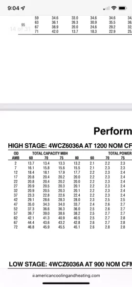

I'd wonder what the mini-splits are doing. Could they be doing frequent power sucking defrosts? Could they be going into a backup resistance heat mode?

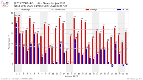

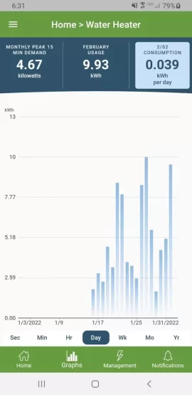

Slim chance, but I wonder about the hybrid HWH. The water temp coming into my house varies a lot seasonally, dropping to near freezing at mid-winter. Could colder water coming in be causing the HWH to kick into resistance mode frequently? I think that can be programmed out to test. I know my water heating load also goes up a lot in the winter, both because of cold inlet temperature, and because of the tendency to prefer warmed water when it's cold. Plus, anything mixing hot and cold for a desired temp (shower, washing machine) is going to need more hot and less cold for the same temp.
The thing about a hybrid HWH, is if it's using inside air, not only will the unit use power, but you're going to need some form of heat to replace what it's taking from the home, so you have to pay for the heat one way or the other in the winter. I would expect that to create a significant difference season to season all by itself. They're a good idea, that makes far more sense in the South, than the North.

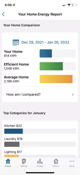

Is your house lit up like a sports field inside and out during the long dark days of winter? Some I see I would need sunglasses to live in!

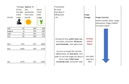

The mini splits, it is a mystery what they are doing. They are I believe about 15 years old. We turned almost completely off in late Dec. We've had some experience with a brand new mini split system in our old house, going through one year of use.
The hybrid HWH...I am awaiting a digital manual from Rheem. It is located in our basement, where hubby says temp is between 40 to 50 degrees since heating season began.(We do not have any heaters in the basement.) It is a 2014 model. Water is municipal supply with supply line coming in very close to heater. I do imagine it is much colder in winter than summer. We do have HWH set on the Energy Saver mode, which I believe will use heat pump feature and switch to electric when no longer efficient. Have it set at 120. It is good for one 10 minute shower.
Our house can shine brightly when my daughter visits, but not as a football field! We had changed all the bulbs to LCD before the Kwh usage went haywire. And have several motion sensor or timed lightbulbs in various locations(closet, rooms where lights are left on....). Several of the rooms have the built in ceiling fans with about 5 bulbs. But we don't burn all those bulbs!
It seems that our next step will be to install one of the Emporia Vue 2 monitors on the Main electrical panel. That will permit us to test all the appliances in questions. When I talked today to the Solar Rep at National Grid, she did not even know something like this existed. Thank goodness for this Forum!
