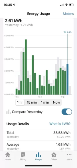

Attached is my rate schedule and a snapshot of yesterday and today’s useage. To get Kw you need to multiply the kWh for the 15 minute interval by 4.
Is it worth it??

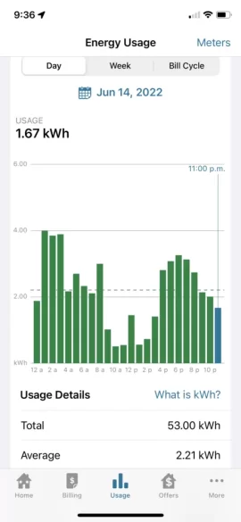

Here is the absolute lowest use for a hot day. Maybe made 95 but the morning was cool. Didn’t use the oven and did takeout for dinner. The egg rolls in the oven last night made a big difference of $7.50. So by not cooking ever in your oven you can save less than 8$ a month.

Looks like you're averaging 40 kWh/day, with a typical monthly 15min peak at 5 kW?
My thoughts was that by not cooking dinner I Dave’s 7.50 a month. (Takeout is 5x-10x times that was the joke in my head).
Is say that 40 kWh was about right. 5kw 15 min peak is about right. But one load in the dryer and that could spike to 8 kw Now that I’m charging an EV a busy week can add substantially to usage.
I lost a broiler element in the oven and haven’t replaced it. So that likely will add another 1.5kw to the on peak demand charge.

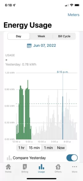

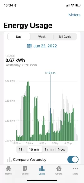

It's been extremely (freakishly) cool here for June, so not much AC usage. but we're at 1690 kWh at 23 days into June. Past months have been 1600 - 2000 kWh, other than December's 3030 kWh, thanks to tens of thousands of little twinkling Christmas lights. As noted previously, our peak 15 minutes at this point in the month is 10.9 kW, although I'd really like to see how high that goes on a truly hot day. With all four AC systems firing, my wife doing laundry and me working in an air-conditioned shop on a hot Saturday, I suspect we might almost double that peak number.
