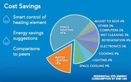

Today, I read about the lowering cost of solar panels and came across this concept. No plumbing on the roof. It uses solar PV panels of about 750 watts to go through a controller that then wires into a standard electric water heater. One concept lets one the 220v elements remain hooked to the house wiring while the other 220v element is heated by solar electric power.
http://techluck.com/
What do you think?
Bill
