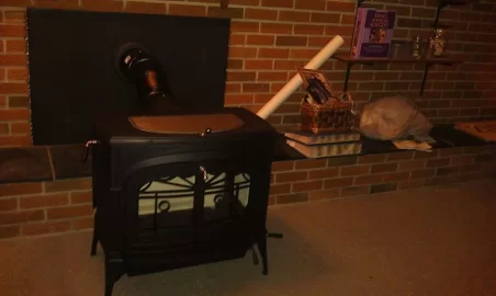

I move into a house where there was a blockoff plate installed previously but higher than the back end of my stove.
My installer found this not quite 45 degree piping with multiple small facets that you can rotate to just about any degree up to 45 you want. I'm not sure what it is called though.
  • [Hearth.com] Encore 2550 Reinstalling need some guidance
I guess it is just referred to as an adjustable stove pipe elbow.
