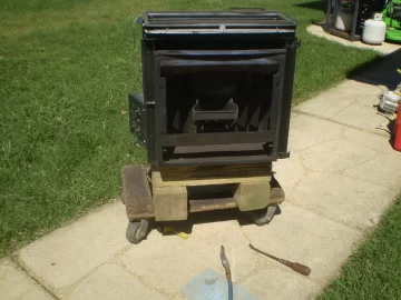

I have said it before. You can professionally scrape, vac, ship and chisel all you want and will never, never, never get the soot out of the stove like compressed air. I pull mine outside once a year and you will not believe the soot that comes out of the stove, air wash, and the dust bunnies from the distribution blower. Sorry.
I have to agree that taking a stove outside and blasting with air will remove the most soot and dust bunnies but humping a stove up a flight of stairs is just not going to happen till its being sold. I still will dismount the room fan and take outside if possible and blast it and some blasting of motor windings with a vacuum going is what I have to settle on.

I absolutely understand. I have a easy three steps out a sliding glass door and my 21 yr old son still at home. That's why it gets done. Yet it is very heavy. The hopper lid comes off and the door. They alone account for almost 100 lbs. If possible, get it outside.
