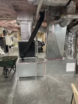

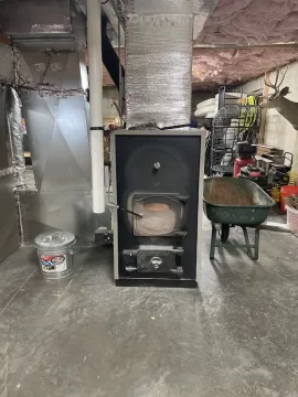

I am very new here and very limited on knowledge of wood furnaces so be easy on me lol. This is my last resort before ripping this unit out and sticking with propane.
alittle history We had the home built 4 years ago and put in a propane unit, and a wood furnance that would allow me to tie Them into the same ducting. Right now if the wood furnance is running it closes a auto dampener to let the heat upstairs not back into the propane ducting but if it doesn’t call for heat is dumped in the basement . If I am lazy I turn the propane on and it closes the Wood dampener and propane works. That’s the function of the unit butttttttt here’s the frustrating part.
the wood stove will heat the house but does not get to the far ends of the home at all and is not reliable steady warmth. The unit seems to not get enough pressure to push the heat to the far ends but I am not hvac tech I climb towers and build dispatch centers. We are having a baby girl soon and wanna keep her room warm. Looking for some input or help. Wood is pretty darn dry. Been on the ground for a few years and out in the open field split for maybe 8/9mths
last cold day measuring the room it was 71 in the hallway and middle of the house and her room it was 61/62
[Hearth.com] Energy king 385ek not heating whole house [Hearth.com] Energy king 385ek not heating whole house [Hearth.com] Energy king 385ek not heating whole house
Wood on the ground can contain more moisture than standing, 8 to 9 months is not enough to season. I'm a year or two ahead, that's split, covered and stacked. It sounds like you have a zone system, if the home temp is met and it dumps in the basement, the ductwork cools. Then opens back up and takes that time to reheat and distribute. To me it sounds partly a ducting issue. Putting the heat in the living space and letting it circulate will do more than dumping in the basement. Normally those who have a furnace load based on demand. How tall is your chimney? The furnace looks like it's been damn hot. Also flexible ducting is a no no with solid fuel.
