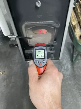

This is with a laser thermometer but thought I’d share until some stuff comes in

200's or even 300's seems awfully low for the face of a furnace like that unless insulated. If your temps are there and the chimney is producing smoke, it should be hotter. That furnace has provisions for secondary air, even if not working fully it should be burning cleaner.
