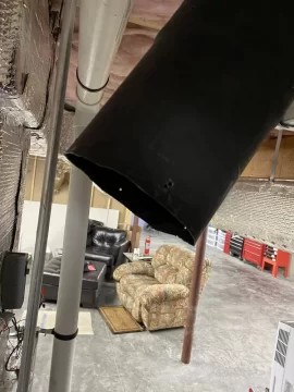

So I got everything installed but ocd about safety so I wanna make sure I did it right
can I cut pipe to make it for better? That’s firstbecause I cut it but if I gotta go get sections I def will.
I cut the bottom to go into the t for the clean out and that goes into the stove
I cut the section coming off the top sweep
here is a load of pictures please tell me what ya think
I prob should have went and grab the angle grinder kinda was lazy after today’s work load

is it ok to cut pipe like I did?
And does it look somewhat right?
the bottom pipe had a knurle on it but I cut it out that went into the bottom t so I can make it fit
Looks good, but your BD NEEDS to be level both horizontally and vertically. Hard to tell from the photo, but the tee doesn't look like it is...???
