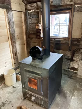

Hoping someone might be able to help. I am new to wood furnaces entirely. Just got a England 28-3500 for my shop - no ductwork, just to dump the heat out into the room.
I can’t seem to get the fire burning hot. I have a thermometer about 12”up the pipe. It’s is topping out at about 250 degrees. When I open the ash door, it skyrockets into over fire. Wondering what might be the issue?
have the top damper slid all the way to the left, bottom opened all the way, and the baffle is slid all the way to the back.
thanks in advance for any help.

Understood - I'll see if I can't get my hands on some well-seasoned wood for the remainder of the year. Curious if you all have a perspective on another dynamic I'm trying to figure out.
As pictured, the stove is in my shop w/ no ductwork - just blowing heat into room. My shop is split into two rooms by a large barn sliding door. Usually, I have the door closed so I'm heating a smaller space. When this is the case - this stove burning at full heat and blowing into the room is going to be too hot.
My plan is to utilize the blower early in the morning to heat the shop up quickly - then unplug the unit and use it as a radiant heat source throughout the day so it doesn't get excessively hot in here. Does anyone have a perspective on whether operating the unit this way is problematic?
