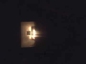

when you are running stove at 6/9 with settings 1/5/2. What does the flame look like? I'm running at that now and flame doesn't come out of burn pot.
Here is a pic of stove at 7/9...with settings of 2/6/2...
What's wrong???

Unless your pellets are on the long side or something, it LOOKS like your're not getting enough fuel delivered into the pot....have you checked the auger coupler to make sure the set screw didn't come loose and it's slipping on the shaft? Also, have you verified that the RPM of the auger motor is correct?
That thing should be cooking you pretty good......
