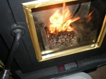

I tried so many brands of pellets including NEWP and Warm Front (this last seems to be really bad...) and it looks like this stove will always have that clinker in the burn pot and pellets bunch up a lot in the front of the burn pot.
I contacted tech support at Englander and changed air/heat numbers around to no avail.
I even emailed Mike Holton over a week ago asking for help, but no feedback......:-(
What's your experience with this stove????
see picts...

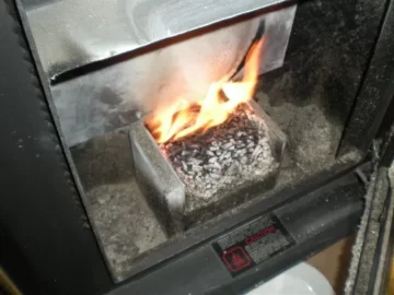

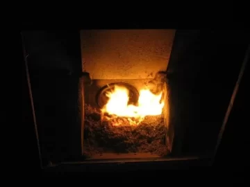

this is another pic.......

How long was the stove burning when you took the pictures?
Mine only looks this way at start-up using the 5-5 heat-blower setting. After 10-15 minutes all of the pellets are burning and ash accumulates at the outer edges. Having unburned pellets after 15-30 minutes would be a due to too much feed or too little air. Factory settings are a starting point, the three buttons on the bottom affect burn rates on #1 and #2 settings and may be adjusted to compensate, some pellets feed faster than others. There is a slide plate in the hopper that can be adjusted to limit feed on the higher settings. You don't indicate flue setup or if you have an OAK outside air kit, they can be a source of air restriction.

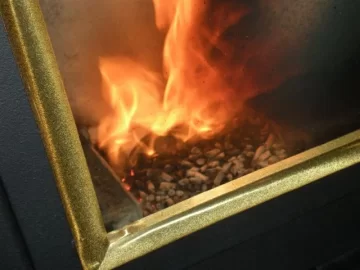

I burn mostly on #1 or #2 settings low feed 4 and low air 6 currently with Lignetics. I do get a build up of light ash at the outer edge (see Photo). When I am home I open the door a couple times a day while burning and cast the ash off to the side. It looks better, however I'm not sure it is necessary. I did get clinkers with some other pellets overnight but it didn't seem to cause problem. Open the door, cast off to the side and good to go.
geek said:
took picture after many hours of operation, gets worse with time; at the begining it looks fine.
my stove was installed per manufacturer's specs and have an outside air intake for fresh air.......
From your photo the pellets don't appear to be completely burned and need more air or less feed. The buttons can be used for 1-2 settings and the slide plate in the hopper will cut the feed for higher settings, assuming your flue and OAK are clear. Other than this, you need "Mike"

As others have said these are pellets that are not fully burned to ash. I run mine at 4-6 also and don't get this. It is most likely due to lack of combustion air. It looks like a lazy flame in your pics. I know mine looks like a blast furnace with a bright flame. It may be that your pallet feed rate is too high, but I will bet your combustion air is to low. Confirm you do not have a restriction in your fresh air line. The leaf blower trick would solve that most likely, but It could create a heck of a mess in your house if you are not careful.
let me clarify this, the flame is not lazy, actually it is a nice and strong flame at the beginning, very nice, but then when stove is running for many hours the pellets bunch up and don't burn all the way down, hence the flame is restricted due to the small room left in the back of the burning pot.
