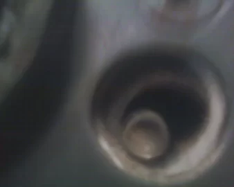

I "thought", it should be centered in the hole, but no matter what - as soon as we try to tighten the bolt, that secures the ignitor, it insists, on being on jammed, on the bottom of the hole - it will not be centered, no matter what we try.

I suggest you posts some pics of your issue. It may help us better understand the position of the ignitor you are referring too. Generally, ignitor location is very important on how the pellets are ignited.
it doesnt have to be "dead center" can be off a bit , as long as you can look through the hole in the front and see at least half of the tip, also its important that its stood back away from th ehole approximately an eigth of an inch to allow the hot air to flow properly out to fire the pellets.

Straight on pic (sorry for the fuzzy), that is with the bolt tight, I had a screwdriver, jammed under it, to hold it up, but as soon, as I remove the screwdriver - it moves back to this position.

ok, loosen it up in the back, rotate it a bit then push the screwdriver in to hold it up , then tighten and see if it stays up in the center where we want it, if it looks good "dry fit" the pot without the gasket and verify its centered well, then pop the pot back out and install the gasket then put the pot back in if all is where we want it
No luck, so far. Too bad the machine shop, next door went out of business, or I would have them make me, a collar, with an angled hole.
Where, it is. in the pic (shoved completely to the bottom, but centered horizontally) is where it returns, when taking the screwdriver (and small pry bar) out.
