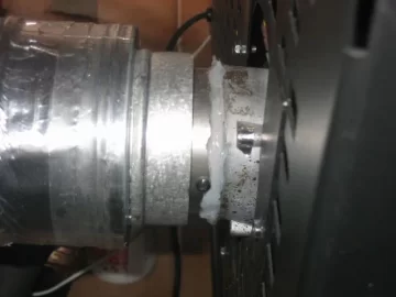

The pilot hole is drilled through the inner pipe of the adapter and the exhaust pipe of the stove at the stove end of the adapter and a dab of sealant placed into the hole and where the screw head will sit once the screw is inserted and tightened. The screw mechanically joins the adapter to the stove so it can't be knocked loose.
All of the sealant makes it gas tight.

Thanks again for your help - I'm totallly clear on where where to drill now with the appilance adapter and god knows I've got enough rtv of every temperature range for 300 to 800 at my fingertips. It's really pretty neat stuff so I don't mind having the extra -- my lastest tube is 700 degree copper. I think I'm only missing the grey to complete a set haha.

As for your stove settings, put the lower 3 buttons at 4-6-1 and pretty much leave them there. Only tweak them a little, if too much heat go to 3-5-1. Do your heat changes with the upper heat and blower settings.
Oh, and here's a pic to confirm for you what Smokey was saying about where to drill the appliance adapter:

Thanks imac especially for the pic. But believe me -- with my Englander -- even 3-5-1 would create way too much heat. My 83 year old mom (who lives with me since she has been ill) would be sitting around in a string bikini and we don't want that now do we :). Last night I ran on magic windows 2-9-1 and heat index and blower at 2-4. Ouside it was in the 30's and inside family room 72-73 and upstairs 66-67 ish - there always seems to be about a 6 deg difference which isn't too bad i guess. Not sure of amount of pellets burned yet - will look at them again about 4:30 p.m. today and see whats in the hopper -- like like it may come down to about 30 hours per bag but we'll see.
