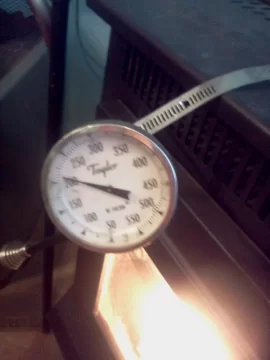

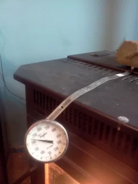

    So here some temps I am getting compared to yours.
    The thermometer is not touching the stove, just temping the air coming out...
    9.3.1   4.5.jpg <<<------------ 225::F with 9-3-1 bottom buttons & 4 / 5 top
    2.4.1  9.9.jpg <<<---------------220::F with 2-4-1 bottom buttons & 9 / 9 top
    burning dry creek premium.
    I will try the 3-4-1 5 / 9 in a bit.
    --------------> I am getting 175::F with these

    It's hard to compare numbers when the measurement techniques are different. Your numbers are certainly lower than mine. Just a non-technical observation, my stove is too hot to touch just minutes after the fire is established.
    Looks like you have a pretty good blaze going in the box.
