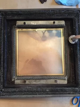

Ok, the new gaskets are on, but I think I might have run into the previous owners own little DIY job. I've never really taken note of how the glass was held in, but with the door out on the table it seemed obvious someone was there before me. For starters the gasket in the glass had no adhesive backing like the new Englander replacement I picked up today, and the only thing holding in the glass were these four little tabs I marked with the yellow arrows in the photo. When installing the glass with new gasket I realized that these tabs cannot be how Englander installed it... they barely apply any pressure to the gasket / glass and I will have some serious leaks. So I decided to sandwich some flat steel marked with red arrows in the photo between these tabs and the gasket / glass. It is pretty tight now, and pretty sure it's not going to leak.
Question is, what does the factory setup from Englander look like? Can I order it?
Could someone please post a pic of how their glass is held in on a 25-PDV?
Door is back on, and I will be eagerly waiting to test this thing out!
There is supposed to be some clearance in regards to the metal holding the glass in place to allow for expansion. If you make things too tight you risk cracking your glass when the stove heats up/cools down. I made this mistake this fall with my wood stove. You want the glass to be barely snug, with the excess play taken up by the gasket which will compress but still allow the glass to expand without putting too much stress on it and breaking it. That glass is expensive to replace too.
I would wait before you fire up the stove hopefully others on here can read this and chime in with advice.

I agree! The OEM gasket from Englander provides the cushion on between the metal plate and glass! I would think he could slice some of the leftover gasket and place under the top and bottom plate?? Food for thought.....

Reading the replied I realize I have the glass way to tight. My subconscious is telling me to seal any potential leaks. Took the door off just now and used a larger piece of flat steel similar to the factory one in the pics, and added a piece of the glass seal to the top of it to help snug down the glass. If I just use the metal the glass has about a 1/16" of play when I move it. I won't tighten it all the way, just snug it in.
This is the correct part number seal, and it is pretty much flush with the steel when glass is installed. Going to call Englander in Monday to see if I can order the parts, but I need to get work done on the shop and use the stove till then.
Attached is a pic of the new setup.
Looks like a good fabrication! Good luck and let me know how it burns! I'll send some of my Street Glide parts to you to get coated once the garage is warmer LOL!!

That looks like you should be ok. The gasket material is holding the glass snug but can compress when the glass and the metal parts expand.

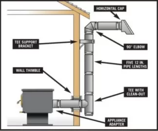

As for venting it looks almost identical to this picture minus the length of pipe on top between the elbow and the cap.
Hmmmmm. Are the 2 bolts under the door lip tight? If not tighten, but snug don't crank down! This may sound ridiculous, but at this point it doesn't matter... Does your exhaust blower sound like it has in the past and is it original? A little 3-1 oil on the center silver shaft can't hurt. You can always remove the fan to clean and inspect, but you'll need a new gasket to reinstall. I believe we've hit all the major areas and my last ditch effort is for you to call Englander. Their tech support is great and your unit doesn't need to be under warranty.
