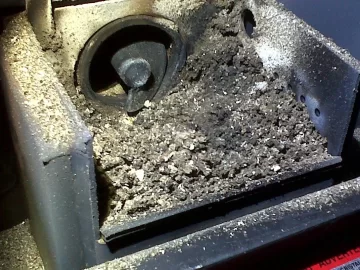

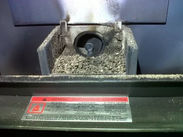

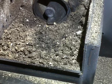

I've had this stove now for a few months and called customers service about what I considered a dirty burn, the had me cut back on the feed rate from 6 to 3. Which is fine I now have more control of the heat and a 40lbs of pellets lasts longer, but my burn pot is still overflowing with coarse looking ash within about 8hrs of running on heat setting 2-3. Does the amount of ash in the pics look right? I have nothing to compare them to.

i'm no expert but that looks like alot of ash for a 8 hr burn. Have you cleaned the ash pot below the wear plate. To me, and i'm no expert by far, it looks like a lack of air flow throw the plate. I get a good amount towards the end of week of burning, and i give it a good emptying and it's good to go.

Looking at those pictures it seems that you do not have enough air coming in to burn the fuel. Make sure your OAK is connected correctly if you have one fitted. Also make sure you don't have any leaks on the venting.
When you have it set on 2 or 1 for the heat range, change the LFF to 4 or 5 and the LBA to 5 or 6 and the blower speed on any number from 2 - 5.
looks pretty much the same as mine but with that said...mine is due for the LBT this weekend
Looks pretty much normal to me for a pdv, I scoop mine every 12 hours.
