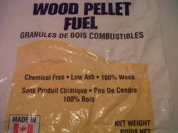

Here the pellets I'm burning 4.50/bag if you buy a ton. [Hearth.com] Englander 25PDV owners I need help with ash pot!

Been doing some window shopping on the net and came across these pellets,can anyone tell me what they think of them by reading there specs.
http://www.homehardware.ca/en/rec/i...0lb-Regular-Wood-Pellets/_/N-ntimd/R-I5515114
Rona just finished a sale yesterday, they sell ecoenergetic. There okay, I've burned about 6 tons in the last couple of years with no ash issues. Last time I asked at Home Hardware they wanted $6.99 a bag.
The Granules LG have always seem to get pretty good reviews. If you can locate 3-4 bags locally they'd be a good one to test burn. Any other brands locally you could post for us to give opinions on?

I increased my LLF to 4 from 3, so I'm now 4-6-1 and in a 24 hour period the glass stayed pretty clean I still scooped out the burnpot twice but with the new bags of pellets I'm using from HD. Things are looking better.
i've tried many differant pellets and tired all kinds of differant setting on my PDV
but lately i run it at 4-5-1 or 5-5-1 and it seems to like it
but no matter where i run it i still have to clean my burnpot twice a day
Thanks to all that help with there suggestions it really put me in the right direction and I know a little more about my stove. Knew I signed up to the right forum. :)
