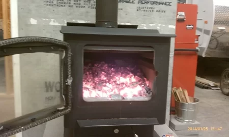

I have spent the last year using the NC30 in "balls out" mode to intermittently heat a cold shop building that is too large. I have attached a photo of what happens when you keep stuffing wood in as soon as there is room.
You can maintain a high temperature 700 or so, without constant stuffing but don't be bothered when the stove temp drops to 600 as the load comes down.
I do not believe that you can "burn out" this stove in one or two seasons so long as you don't overfire it and melt it. I will inform you that you can indeed melt this stove even when temps are reasonable so don't go pushing the stove with high throttle settings when the surface is past 600.
The most effective way to get heat from this stove is to operate it at 600-700 all the time and use fans to steal heat from the surface of the stove. Think of it like a furnace and the surface is the heat exchanger. Incidentally, you would be better off with a furnace.
3100 SF is not impossible to heat if it is reasonably insulated, open, and you are willing to feed the NC30. I would not recommend depending on the NC30 for 100% of your heat though, be prepared to supplement.
