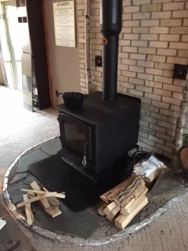

Hi All, great information on this site! I recently bought a cabin up in New Hampshire the had an old Timberline stove in there from the 70's (I think) which was about 21" D x 24.5 W x 33.5 H and I want to get something more efficient and something with a glass viewing window. I do have a cord of Dry Ash waiting for its new home!
I was originally going for a US Stove Model 2000 form TSC because it has gotten great reviews on HD, TSC and whatever YouTube's are out there and I like the looks. The size seems appropriate for my cabin as well.

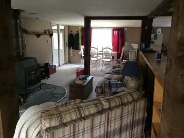

But I found this Englander 30 on CL last night and got the guy to $425! I'm just concerned that it's going to boil me out of my living room as the set up is that the couch is pretty close to the stove (see pic) and that old Timberline beast used to cook us pretty good.

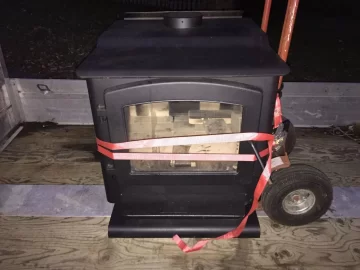

Thanks for all the help!! I went ahead and nabbed it up. It is basically brand new, the guy bought it without measuring and it wouldn't fit into his fireplace. Figured that out after he burned off the oil and heated up the paint outside, so no return.
This thing is a beast, I can't wait to get it up in the cabin and laugh at the snow and wind!

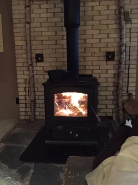

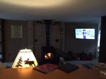

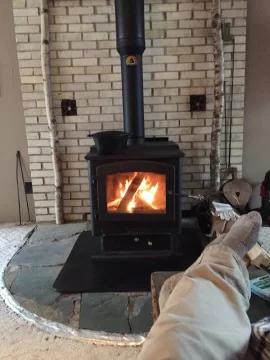

Well a few weeks later and I was able to get back up to the cabin and get the 30 installed! I was pretty nervous about the size but it seems to fit perfect and will def do the job! I think I need to get better wood for next season, def a big difference in temperament between this and the timberline! (just bought the place this year so I haven't gotten a good wood rotation yet). Thanks again for everyone's help on here! Maybe next spring I'll do something with the old beat up bluestone hearth...
Reactions: CenterTree
ohhhh does anyone have a nickle draft control handle they want to sell? The box was missing that one and I had to put the gold on, the mismatch is making me a little crazy, haha.
The draft seems to be pretty okay smoke rolls right up and doesn't come in the cabin at all, it was probably only 38-40 degree's outside so hopefully it'll get better the colder it gets. I think the wood is not dry enough which is why it starts to die down when I close the door and dial down the air. I tried 2 of those red stone blocks from TSC and they seemed to do quite well so I'm assuming it's the wood and not a draft issue. Have a moisture meter coming to check on it though and planning wood storage build for spring for proper rotation!
