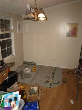

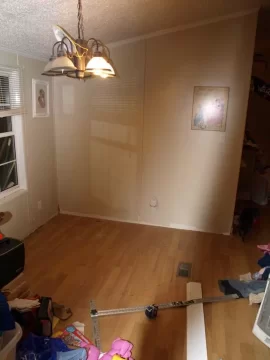

Picking out a spot to get started
  • [Hearth.com] Englander 30-nc Hearth build and install with pics

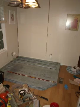

Laying down the some studs and you see the inspector checking my work :-P

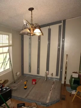

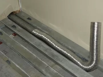

First row of studs down and .5" of wonderboard on it, and now second layer of framing and two coarses of wonderboard to come. also a pic of the OAK pipe.

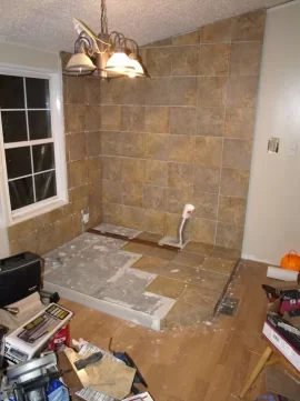

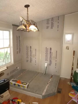

Walls are up now on to the fun stuff.
And now this pic brings me to my current amount of work as of right now.

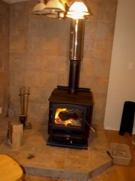

And then the final product. will be here ;-)
Still needs trim and cleaned up but she is a burrnin and I beat north of 60's deadline :-)
So, what room is that. It kind of looks like it used to be the dining area.
Yeah it was for a while but I have been lurking around for here for a while an I found the general consensus to try to locate in as central in the home as possible. I think where the dining room is now works alot better, its right near the kitchen. I'm gonna get rid of the light in the pic and put a nice ceiling fan up.
