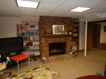

That's all the details for now. I'll hopefully be installing everything next weekend. Have a the stove and flexible liner on the way. I'll post a pic of the fireplace and progress as I go!

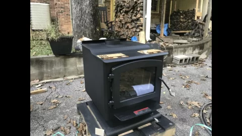

Outdoor break in fire in progress now. It's hard to build a fire halfway! I want to just load this puppy up but I don't want to be out here all night waiting for it to finish LOL.
Very impressed with the construction of this stove. Need to order a thermometer for the top. Most likely won't have a real burn inside until later next week. 85 degrees here in SC!! Ready for colder weather!!!

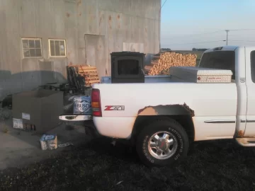

Here is my 30-NC during my break-in burn. It looks incredibly redneck, I know. I had it shipped by freight and used my neighbor's forklift to unload it off the truck into my truck. I put it into my truck because I knew it would be easier to move around after break-in and getting it into the house.

I'm officially sold on this technology. Even here with only 2 feet of pipe and 75 degrees this evening I got into secondary burns. The control on these EPA stoves is unreal. And, no smoke at all when the door was closed.

Hum using equipment for the heavy lifting. I'd say that's smart not redneck lol.

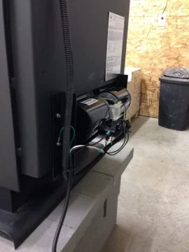

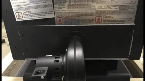

Got the stove into the basement which was a challenge. Pulled it in on a dolly using the mower because there is a pretty steep grade getting up to my basement door.

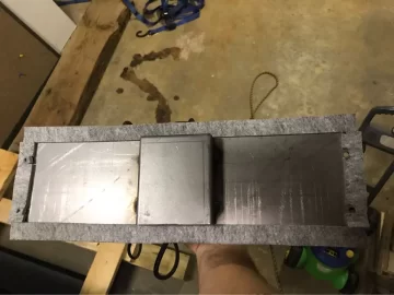

Once inside I hooked up the blower and it was rattling like crazy so I added this high temperature gasket meant for BBQ grills called Lava Lock.
I added this to the plate that holds the blower and it took away all all vibration. Now I just hear the blower and it's much more pleasant and perfectly acceptable for me sound level for me.

Just make sure the "Lava lock" stuff will take the temps expected and is ok for wood stoves. You don't want to wake up to fire alarms and/or smoke/odor.
Says it has a 650 F limit. I'm assuming that's ok for that area. It's a baffle behind the actual stove.
We will see how it goes!

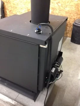

When you really want to get some flow/heat from the blower system you can step up to a much bigger blower and add a convection deck. Very nice improvement in output. Almost makes it a mini-furnace
I really like that. Any information on the blower motors you used?

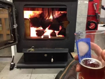

So highbeam, what's with the keys in the front on picture of your stove?
Those are the keys to the walk in beer cooler. :cool:
Ha! This stove is in my detached shop so I developed the habit of throwing my keys there. Otherwise I lose them. They don't feel hot until you drop them into your front pants pocket and then the burn starts!
