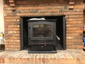

Got her in! Didn't take any pics of the install. It was much more labor intensive than I thought but it's in and ready to go!
Also, the hearth is a bit short but we are in the basement on a concrete slab just got to trim the carpet at the front to gain the right clearance.
Next week is supposed to be in the 40's at night so I'll post back when we fire her up!
Are you able to reach back there to turn the fan on and off or will you just unplug it each time?
Looks really nice! While this is still open, I'd be inclined to install a separate outlet/switch for the fan.

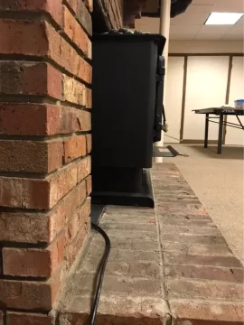

Can you take a side picture to see how far it sticks out of the fireplace?
Thanks! That's a great idea. At some point I think I'll add some sort of switch. Since the stove is freestanding I won't be adding any sort of surround. It's nice because the opening is large enough for me to get in and oil the motor and I have enough space to do some additional wiring at some point.
Just my honest opinion. If you want it to warm more of the house up I would figure a way to have that stick out more. Nice job though and happy burning!
Sent from my SM-G950U using Tapatalk
Thanks for the feedback. I added a block off plate at the damper. Hopefully that will keep the majority of heat in!

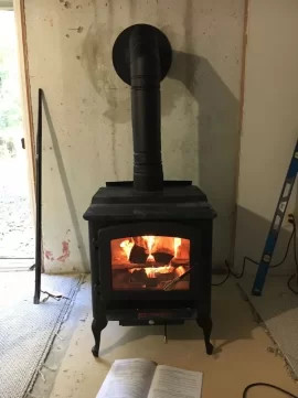

Very first fire in mine right now.
Nice! That's a good looking fire and install.
