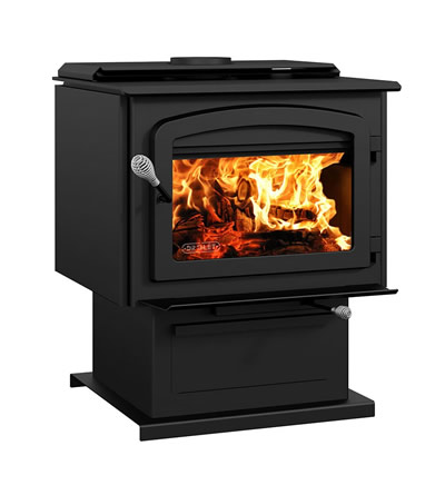

Hello everyone, Thank you for the replies. Last night I fell down a wood burner rabbit hole. Reviewing BTU outputs and sizing I have started to question whether or not I'm over sizing for my home going that large. Also, with having the wood burner in the basement with no fresh air intake (note I have had no issues with draft with the smaller wood burner) I'm wondering if the larger wood burner will have issues. After comparing warranties it looks like Drolet with lifetime warranty are the best option for my budget (loved Blaze King but not in the budget right now and Englander changed to Blue Ridge models). The two models I'm debating between are the Drolet Escape 1800 and the Drolet HT3000 (I couldn't find the Myriad III or Legend III in stock online) My concern is maintaining a good stove and stack temp in the larger HT3000 would heat up the house too much? I live in Northern Michigan (zone 6). For comparison, my 96% eff. propane furnace is 45k BTU. I go through about one 500 gallon tank of propane in a year while also using the small Century wood burner on the colder days to supplement. The furnace heats the house fine without the wood burner with normal cycles (not undersized), I prefer to use the wood burner to reduce propane consumption and in case of a loss of power etc.
Heating from the basement is a lot more forgiving for going oversized on the stove...I say go big and don't look back.
You can always build a small fire in a big stove, but you can't build a big fire in a small stove.
The HT3000 would work. There is also the Escape 2100 with their 3.5 cu ft firebox.
