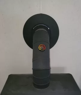

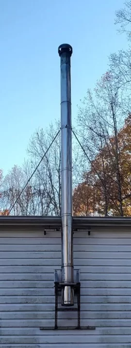

Unfortunately, some of that additional height is negated by the out the wall installation. Every 90º turn reduces draft and there are two 90º turns in this system. Can you post a picture of the installation? Post one of the whole indoor setup and also of complete the outdoor chimney system.
Several Canadian stoves work well with shorter flues. However, make sure the issue is not something other than the flue height first. Eliminate other potential issues like chimney location relative to the roof and local terrain, potential negative pressure in the house, air leaks in the flue system, etc.

I keep a window beside the stove open about an inch to two inches since I have owned the stove. I think the main issue with the Madison is that the large door is the reason that the stove spills smoke. I could live with this stove but the smoke is enough that it is making me sick; I got very sick last year and I may have even gotten some lung damage. Plus the house stinks of smoke the whole heating season. I could not go through the roof because it is a double wide with a vaulted ceiling; there is no way to easily hang the ceiling box and there was a ceiling/roof truss in the way. I am not looking to spend money but if I can get a stove that doesn't spill smoke then I would consider replacing the Madison. In the chimney photo below there is 15 feet above the tee.
[Hearth.com] Englander 50-shssw02 (Madison) Stove Replacement[Hearth.com] Englander 50-shssw02 (Madison) Stove Replacement
Does it smoke out the door when the fire is burning hard? What kind of flue temps do you see when heating normally?
It looks like you have done everything possible to improve the situation. The solution may be to start over with an easier breathing stove from Drolet, Regency or Pacific Energy.
