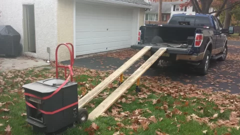

A few days before I had moved an EP completely by myself onto my trailer, off my trailer and into position inside the house. The seller had completely filled the hopper so as a nice bonus I had an extra 45lbs to deal with! Fortunately there were only a few stairs involved, and the descent from the trailer. So I built a ramp and was able to manage with just my dolly and some straps to hold it on tightly.
Good luck with the move!
That was easy! Now I just have to drill through my 12" block wall to install it.
