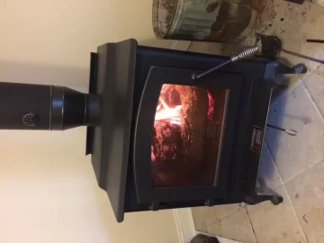

Well, it was 60 all day in KC yesterday, so I started the NC30 for the first time to start the seasoning process. Thanks for telling me about what to expect guys. The new finish burn-off smoked up the whole house. And the smell. Woo wee! LOL! But it is done! Wasn't too bad, as we were gone most of the night. Once we got back, the house was clear and stink-free.
Question, Do I need to move my temp gauge off of the flue and onto the actual stove? See pic. Thoughts?

You need two meters, one on the stove top right in the middle just above the step near the flue collar and then that second one up on the flue.
The flue one to know when you are overheating the stovepipe (it has a rating that is easy to pass) and the stove meter to keep the stove at 700.

Of course you don't "need" any meters but if you want to measure such things then both locations provide vital, different, information.
