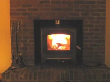

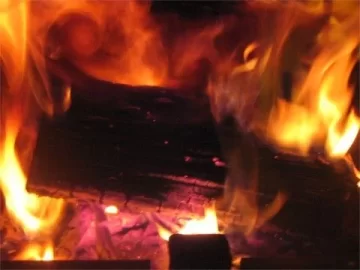

Before you know it you will be looking at this. First fire of the 2007 season.
[Hearth.com] Englander nc30 burning problem
Reactions: jnc1991 and Dix
