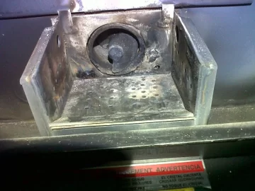

Anyone have a pic of the holes you close up ?
Not right now I do not, but if you lift out the burn plate with the holes in it , they are at the bottom of the burn box . There are only 3 holes down there. 1 big hole which is your combustion blower hole at the back under the auger. The 2 we are talking about are to the left and right of the big hole on the sides of the burn box. Hope that helps
On the PDV there are four large holes in the burn pot. Two are at the top of the burn pot right and left and two are under the wear plate to the right and left of the air intake tube. It's most important to close the bottom holes as they supply air to the upper holes. I plugged both sets to prevent ash from building up in the top holes.
  • [Hearth.com] Englander pdv-25 steel wool mod.
