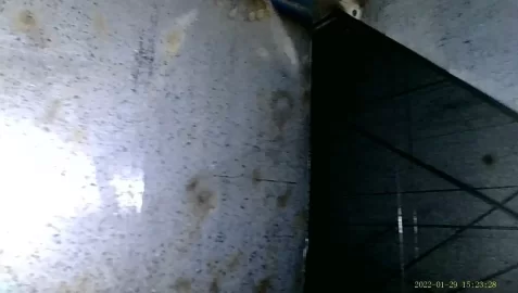

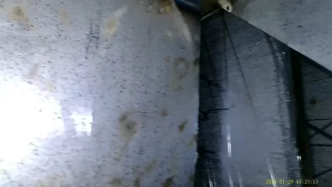

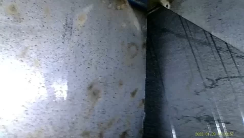

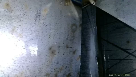

With my new slinky cam, I was able to confirm that the primary damper is OK. Here's a series of photos that I was able to take to confirm. It shows the damper fully closed to completely open, as I move the main air control. That's one variable removed.

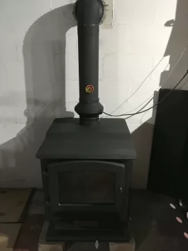

I also took a few photos of my inside set up, but I doubt it will give you much to go on...
I'm going to have to sign off for today, and complete the removing of the baffles and video inspection of that for tomorrow... the snow, wind and cold is wreaking havoc on the mini-split heater in our remote cabin, so I'm off for another fun-filled adventure in the dark for the rest of today.
new stove set-up.jpg stove pipe and thru-wall.jpg damper fully open.jpg damper 3-quarters open.jpg damper partially open.jpg damper fully closed.jpg

Also describe the starter pipe leaving stove to the adapter... Your internal piping can make a difference on how well the stove lights and drafts. Some stoves require a foot or more of starter pipe before a 90 and some you can run a 45 right from the top and it will work fine even with 4 feet of pipe and a 90.
I posted a few photos earlier today... I have about 3-ft of single wall before before I get to the 90° and the thimble that goes outside.

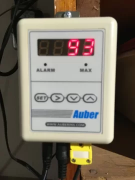

Dont worry only bang so much and each stove collar is different spec even if it say 6 inch.
I notice the blocks under stove did you use a adjustable pipe after the draw collar and before 90. Or use blocks to match the height.
That's great pipe temps..now .mine is 28 internal and it's 11 degrees outside...
My electrical bill is already crazy 450 a month I can already imagine what the draw collar would add but I want one...I was thinking of putting it on a switch to shut it off two days after shutdown when the coals are not burning.

The blocks under the stove are the ultimate in laziness... I didn't want to have to stoop to view the fire from my stove-tending chair! The pipe above the collar is a single piece that my installer cut to fit.
That draw collar is 500 W, so it'll definitely make itself known on my next electric bill--still, it's so nice not to have to start the flue when it's cold out there. I'll most likely disconnect it when the weather warms up--if it ever does.
