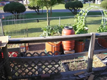

I know exactly what you mean. I did the same thing with my water and I bought rain barrels
