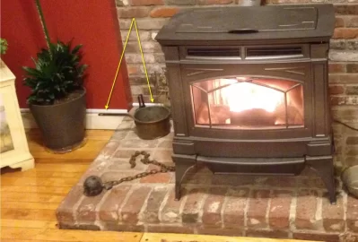

0. Turn off the stove and unplug it.

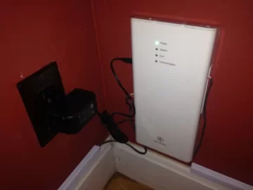

1. Choose the location and mount the control unit near an AC outlet if possible.
Use wall anchors or wood screws.
If you have the optional remote module, mount that into the control unit first.
Not too close to the stove but not too far away maybe ideal

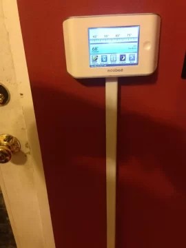

2. Mount the Head at the normal height on the wall approx 5 feet off the floor.
3. Run 4 conductor solid jacketed wire from the control.
If using hide channel like I did mount that on the wall first.
I used 5 cond. T-Stat wire from Lowes
4. Connect female spade lugs on the regular 2 cond T-Stat wire and plug into stove.
Run wire to RH and W on the control box.
5. Plug control box into the wall.
6. Run the Install wizard on the T-Stat touch screen to choose your Wi-Fi router name and lock it in.

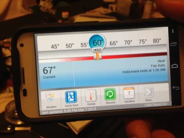

7. On your Iphone
Download and install the Ecobee Smart Stat app from the App store.
Don't forget your apple Appstore password.
8. Set stove to either Auto-On/Off or Auto-Hi/Low
Now you can either setup a daily program schedule for your stove or put the set temp on hold and change the set temperature up or down to what you desire from anywhere in the world.
Yes, it does have the short cycle delay for the pellet stove.
What I like is the button for the weather forecast and the optional remote module for additional sensors. Also what you see on the wall stat is also what you see on your smart phone!
