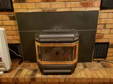

I recently bought a used Enviro EF3 insert. I don't know exactly how old it is, I bought it from an elderly couple, when I asked how old it is, she just said they've had it for years. It is in great shape, except I don't think they ever read the manual. For instance, she pointed to the damper and said they never used it, then pointed to the exchange tube cleaner knob and said it was another damper and they never used it either. Also, the T-pipe in the back had the cap at the bottom siliconed on, there was no way to empty it, it blew black soot everywhere when I first turned it on. She said the blower motor didn't work, but one tap with the butt end of a hammer and it it freed up and works fine, except it seems to be stuck on high(?) speed.

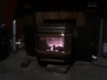

This is what the flame looks like. This is on high flame setting. The fake logs were in when I took this pic. Sorry for the poor quality, but you get the idea.

Thanks. I have seen that manual before. This part best describes the flame I get:
"A small blow torch like flame is a result of too much oxygen being supplied to the fire. This causes the flame to become very short and brisk with a bright yellow, almost white, flame appearance. There will also be a lot of embers or sparks exiting the flame and burn pot liner. To fix this condition, close the slider damper until an efficient flame is achieved."
However, as I said, I have tried every imaginable damper setting in small increments (1/8" or so) and nothing helps.
