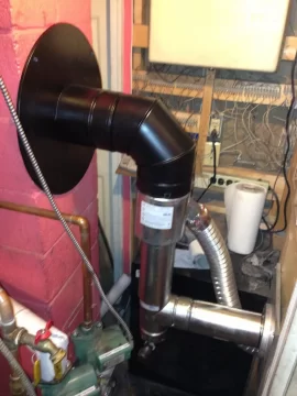

The absolute best solution is to pre-heat that outside air to make it warm and keep it dry with Selkirk DT venting that I install.
see pic below
see pic below
Are you saying that preheating the air drys it? Where does the moisture go?
