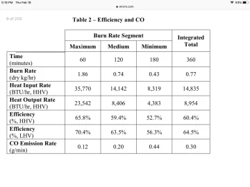

I appreciate all of the data. here is the condensed version. Also burns on low at 10,000 btu's, which is that something that won't blow you out of the house when say it's in the 40's? Anything above the heat pump handles just fine but 40 is around the cutoff when it needs help. Also want to be able to run just for ambience.
[Hearth.com] Enviro P3 owners
This is the epa report for the M55 series, as you can see it falls far short of Enviro’s claims. At first I thought the unit tested must have had some issue but that begs the question why the company wouldn’t have wanted a retest. Unless they only cared that the unit passed certification.

New rules were handed down last year and not many stoves complied so alot of them had to do some tweaking. Enviro was not the only one.
