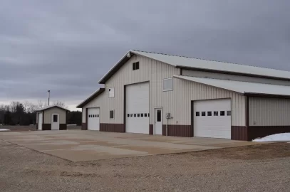

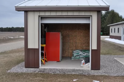

    There is a way around the tax thing in most jurisdictions and that is to not "permanently attach or anchor" the structure to a foundation. This is how mobile homes excape paying property taxes. At least here in Michigan anyhow. I do not know all the regs in other states.
    The pictures attached here show how one homeowner handled it when he switched from an OWB to a better boiler.
    The old CB sat on the pad you see under the little building. He had the shed built on the existing pad and did not anchor bolt the shed down to it. There's some construction adhesive underneath the treated plate but that's it. He insulated the new boiler shed and we connected the new boiler to the existing lines. There is no other heat in the boiler shed other than the heat from the boiler, which itself has 3" thick heavy glass wool around the vessel. It is connected to a high mass radiant floor (6,400sq.ft) and it will literally go for 24-30 hours without firing when the temp gets up into the 20* range. No antifreeze in the system. Windhager pictures 163.JPG Windhager pictures 175.JPG

    It's about 10x10 outside dimensions. That gives him enough room to store about 3-4 weeks worth of pellets and enough area to work around the boiler.
    For everyone's info, this particular installation has no storage in the typical sense of large water capacity. The owners "storage" is the 6,400 sq ft of concrete in the building. That factor along with the 3:1 turndown on the boiler keeps the hours run per cycle very high.
    Any wood fired boiler, regardless of inside or outside, benefits from storage. There are a number of reasons the European contries do not subsidize purchase of wood boilers if not accompanied by an accumulator (storage to us) tank. Many of those tanks have multiple coils that allow heat input from other sources like solar plus a coil for making DHW. I wish they weren't so expensive to ship over here.
