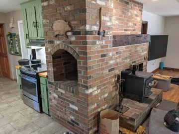

They say, pics or it didn't happen. :cool:
Here I was getting all ready to show what an Osburn insert with no surround looked like. Nice!
