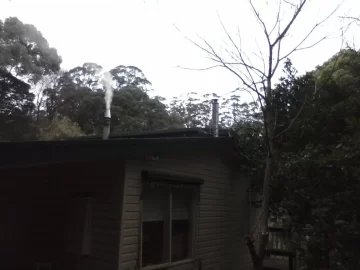

Just thought i would show this picture on here. I have 2 stoves - the main stove is only a couple of years old but it is not EPA compliant. The second stove downstairs is a Country Hearth 2000 which is EPA compliant. I have both stoves running using the same wood and both are closed down to minimum. The flue on the left with the smoke coming out is the non-epa stove and the one on the right is the epa stove.
They are both using exactly the same wood. It just goes to show the benefit of the EPA. I must admit i do love both stoves and the non-epa is 3 Cu Feet and can heat the whole house but uses quite a lot of wood. It also takes a while to heat up (Cast iron) but also holds the heat for a while. The Country Hearth heats up very quickly - 10 mins from lighting and the stove top is over 600 and climbing fast.
[Hearth.com] EPA Vs Non-EPA Stove
Excellent comparison shot. Thanks!
Dramatic. Had they both come fully up to temperature by the time the pic was taken?
Yes they had been burning for ~ 8 hours. I normally only burn the smaller stove during shoulder season and winter nights. The 'big' one i run 24 hours through our winter June - Sept.

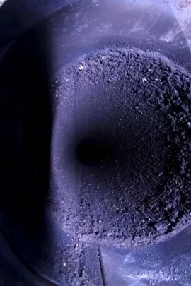

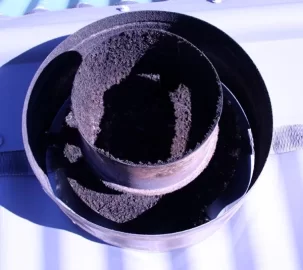

You wanted a longer term term user review, well here is one from the professor next door. His is the insert style stove that features on the front page of my website & only has my MK I original installed. He first said to me he wouldn't be much use to him as a referee because he burns the unseasoned wood from his orchard all the time. I cleaned his flue for him and have attached an image of that. I don't have huge experience as a chimney sweep, but that looks pretty clean to me for 5 years use, 4 of them with the IntensiFire. Be interested in feedback from the sweeps here. Mine gets a lot less, but I clean it annually and push the boundaries at times. I have seen one with 3/4" around the circumference during an install.
Testimonial for the IntensiFire
Jason installed the Intensifire on my woodburner about 4 years ago and it has been a success in every respect.
It has undoubtedly generated more heat from the same amount of wood fuel, so our house has been really warm over the winters since then. We use wood off our own property, which varies a lot in size, quality, and dryness, so it is almost never fully seasoned, yet it lights and heats the house very well. I have only just had the flue cleaned after all that time and found that no more than a cupful of soot had collected in the whole chimney. The version of the IntensiFire I have was the prototype and I understand from Jason that he has introduced improvements on subsequent versions. I thoroughly recommend the device.
Mike from Warkworth, New Zealand
