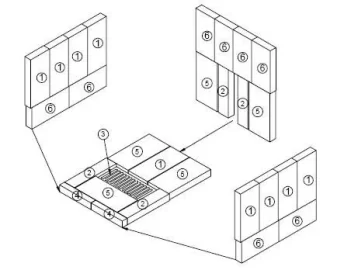

The design features one needs for a good design are easy to look for: Lots of refractory, heated secondary air, good sealing around all openings and joints to avoid excessive leakage etc. The firebrick is certainly there.
  • [Hearth.com] EPA wood furnace - Caddy
