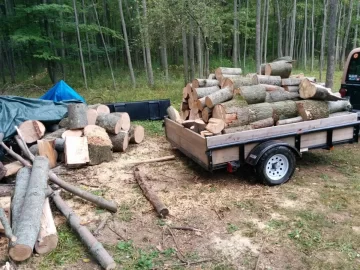

This trailer is rated at 2400 lbs I believe.
It was touching the fenders with this load. Dead standing maples. 1.5 trees worth in there.
