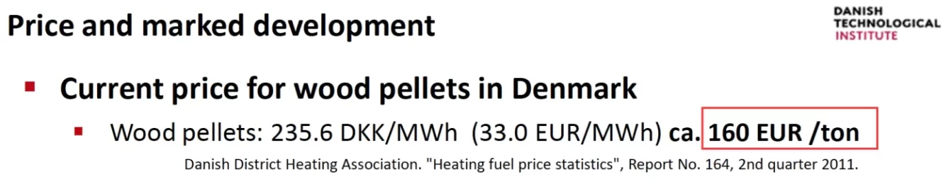

Pellet prices in Germany don't seem that different from here. Maybe 20% higher? In Denmark it looks even cheaper. I would think they would invest in insulation first for better payback. And they heat smaller areas. Again, in multiple trips to Europe I have not seen many high end stoves installed.

Note: in Europe Tonne usually refers to metric tons (2205 lbs.) so the cost for pellets in Germany may be even lower!

Actually that is correct. That is per metric ton. Good point.
I did a bit more looking around and found pellet prices surprisingly affordable in Europe.
