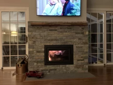

Hello, first time poster. I am looking to replace an old Heatilator Mark 123 that I believe is original to my home. The fireplace is in a single-story family room that has vaulted ceilings and measures approximately 24' x 24'. This room is above the garage and, while it is connected to the rest of the home, shares relatively little wall space with the main part of the house.
Here are some pictures (please don't mind our clutter):
![Even small fireplaces generate too much heat? Even small fireplaces generate too much heat?](/talk/proxy.php?image=https%3A%2F%2Fi.ibb.co%2FS6BCq4t%2FIMG-0752.jpg&hash=ee74f63ca09d46cdf116484dfdf667aa)
I have called around to my local fireplace shops in search of a replacement ZC fireplace that will allow me to build a fire that will actually heat the room. The feedback that I am getting seems to be that even a small EPA unit like the Ambiance Elegance 36" will throw off too much heat for my room, and I would need to find a way to route the excess heat elsewhere. On the other hand, a traditional style ZC fireplace will just send the heat up the chimney.
Is there something I'm missing here? Is there not a solution that will get me some heat from the fire without cooking me alive?
