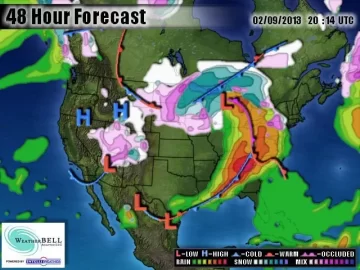

Tell me you are joking Zap. another one?
That's what I saw on TV last night, this morning the same guy said it was possible that a second one would come in behind it on the weekend, hope he's wrong but check the weather.
This is some chit coming our way, the west coast is sending us some not so nice systems along with a dip in the jet stream.
