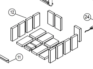

Something is not right then. Mine is about 15 inches wide.
Do the side firebricks sit on top of the floor bricks or alongside of them? If the former, then that would explain this and you are correct.

The side bricks sit on top of the bottom bricks. 15 inches wide. I'll save some of my short splits (14" or less) to be laid EW in the back (as a sleeper log, if that's the correct term) if I haven't stacked the wood high in the box.
Thanks for clarifying this. My next-door neighbor has the Spectrum and tells me he can load E/W but apparently, that must be with 14" splits. Duly noted.
