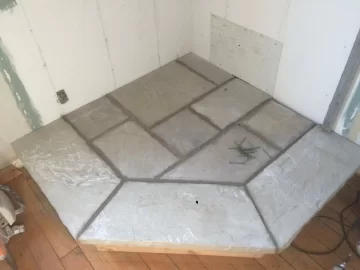

Just bought a house with an existing wood stove, an old dutchwest that we are replacing (had a tiny veiwing window wasn't maintained). Our first pick was a drolet pyropak which all the clearances work for. Then lowes flyer came out today with a great deal on the pleasant hearth 1800 for only 50$ more then the little pyropak. My current issue is now that the hearth is only 1/2 Durock, 1/2 or mortar, and 1" of credit valley flagstone. R value of 1 if I'm lucky. And the pleasant hearth requires r value of 2. So my question is.... Is there a way to lower the required r value for the heart? Heat shield on bottom of stove? Any option other the tearing it up and redoing it (just moved in it's crazy enough as it is)

The hearth appears to be newly built I tore the front facing off to see wat was under it to calculate my current r value). And it does look nice.
Here's the hearth as it is no. 1/2 Durock 1/2 masonry to lay the stone in and 1-11/2 inch of stone.

I am not aware of any acceptable method to reduce the R requirements of the hearth. It is not like using shielding for walls, etc.
